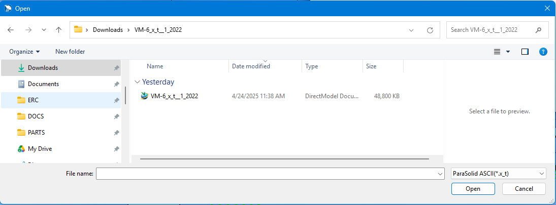

Hello, should BobCad V37 SP2 be able to open this file?
can anyone open this file with B.C.?
THX

Hi Richard,
I tried your VM-6_x_t__1_2022 Haas file in a few versions of BC, including V37 SP2 and it wouldn’t open in any of them. All versions of BC I tried, the program would hang for a couple of minutes and shut down with no warning or error message. I did open it in another CAD viewer, JT2GO, and it was fine.
David.
that was my exact experience too…
I wonder Why BobCad Chocks, it knows that file…
I will take a look at the JT2GO program too.
Thanks

In your experience has BC opened other cad files you have that are the same format or just this VM-6 file.
Ya, I Have opened a Parasolid file here and there… they are usually a single layer or one solid component file, unlike this one…
