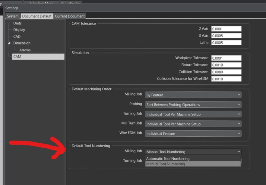

Make sure in Settings, Document Default (and Current Document), CAM, Default Tool Numbering is set to Manual Tool Numbering. If not, even if you have a tool number in the crib, it will change it.
Hi Brian,
Thanks for the input. I do have and have always had the System Setting to Manual Tool Numbering. The software will still re-number tools in certain instances when you are not expecting to, mentioned above and in other posts. I believe the system needs some fixing here, this has been an issue for a long time. You can loose confidence in the software and you always have to be double checking your work. The new tool manager is good and has some useful options :+1:, but still has the stain of tool renumbering. :unamused:
