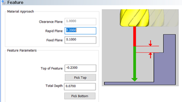

I’ve been using BobCad for some more standard 2 and 3 axis machining in my home shop on both my mill and a CNC router. I’ve recently started to try my hand with some woodworking and want to do some wood inlays.
I’m working with 2D DXF files that are the outline of the shape I want. I bring one into BobCad and make a normal VCarve feature with tapered pocketing to make the ‘hole’ in my block I then bring the same DXF into a second file, flip it 180 degrees and VCarve out the inverse to make the ‘plug’
Problem is the plug is that what should be the bottom of the plug is the same dimensions as the top of the hole and things don’t fit.
I’ve tried looking for tutorials, but everything seems to be for Vectric’s VCarve software, which obviously doesn’t help much. Is there something I’m missing? I can’t find any settings to specify an offset if the outline should be the top or bottom. Any help/advice would be appreciated.

I was thinking about it a bit and think I might have an idea on how to go about it, but am not entirely sure. I’m at work and can’t access BobCad right now, so I have to guess at the menu names. It seems like the VCarve feature moves the cutter so that the edge touches the profile at Z = 0.000" (top of the part)
If I have the top of the part with the hole set at 0, but then set 0 at the bottom for the plug that might trick things into doing what I want. There’s the normal depth setting early in the process, but later on in the VCarve sequence there’s a box for setting cutter depth (when you also specify the step over for cleanup) I’ve set that to be the same as the depth, but am wondering if that might do something different as well. A CrappySketch™of what I’m thinking is also attached.

I was facing the same problem, and I have found a simple solution. When setting up for the male part, simply change the “Top of part” value to a negative value equal to the depth where you want the finished part to be the full width. For example if your female part is cut 0.25" deep, and you want the male plug to fit with a 0.02" glue gap at the bottom, set top of part to -0.230".
If you want the male plug to have a total depth of 0.30" then set the “Depth of cut” to 0.070".
